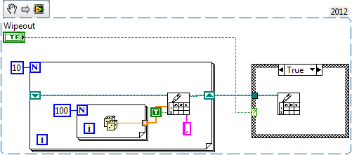

I appreciate that you are reluctant to share your code.  So I wrote some of my own.  It's a utility that creates data using Write to Spreadsheet, 10 rows of 100 random entries.  There is a single control, "Wipeout", that, if set to True, wipes out your data after writing it, and if left as False (default), does not do the wipeout.
I'm sure your code is more complex than this, but could it have a "feature" like this buried inside it?  This seems to me much more likely than a function that has been present in LabVIEW for, what, a decade or more?, would, itself, wipe out data.

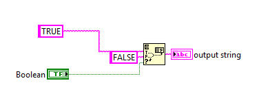

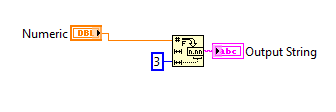

The conversions are (each one is its own VI called by everything to clean up block diagram):
Double: dbl-conv.PNG
Timestamp (conv VI is just the double conversion VI):time-conv.PNG
Message 20 of 22
