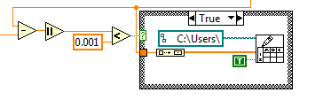

I have the following problem which I can't solve myself.. My vi generates some data, the capacity of the capacitor, what I want to write to a text file. This must be only the stabilized value. Now it writes all data from 0 till 50 for example, and I want only the data when it's stabilized. I have some attachments to make all clear what I mean.

The VI doesn't look like the picture you attached.
If you want to write a value only IF some condition is true, you need a CASE structure.
See the attached VI.
Run it and flip the GO switch. It simulates a capacitor charging.
It uses Shift registers to remember the previous value, and compares each new value with the previous.
When the difference is less than a tolerance (beware of looking for zero difference), it Resets itself.
Put your WRITE TO FILE code inside that inner CASE and that's what you want.

Thanks Steve! I try to implement in into my VI. The picture is only a small part of the VI. And a few parts are missing, uploaded an older version accidentally..

It is working, but only when  "append to file" is false on the "write to speadsheet file". When I put this on TRUE then I get a whole list like in the .txt attachment. And I want to do several measurements to calculate the mean value.. Any idea how come? This time I attach the correct VI.

Take a look at what you're doing.  The program is doing exactly what you're telling it to.
You're telling it to append to the file anytime the difference between one sample and the previous sample is less than the tolerance.
If you want it to only write the stable value once, you've got to tell it that.
My example captured the stable value and turned itself OFF.  You've got to have another flag that stands for "I have written this value to the file already".  It starts out as FALSE.  You don't care aboutthe stability (don't write, or even compare) if this flag is TRUE.  When you write, you set it to TRUE.  You need something to reset it - a button click or something.
The GO switch in my example did this - you can use a STABLE light or something similar, or maybe another ShiftReg.
