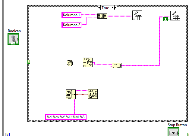

Thank you all for the replies. It finally works. I have another question. How to wire it so when I push the button then it saves data.
The problem is that is saves only one value and within every next iteration the value is overwritten by the new value.
Message 25 of 29
(1,874 Views)
You've programmed it to create a new file with each iteration. Why don't you move the header creation outside of all the loops so that it only runs once?

@JÞB wrote:
That's because Tim forgot to change the display fomt of his format specifier string.  \\ sends a literal \ they shoub be single \s and \code display so \r and \t a4e return and newlineSmiley LOL
No I didn't.  I even have the string display style turned on so that you could see that my constants are in \ Codes mode.  I had to do that in order to get the tab inside the timestamp formatting.
