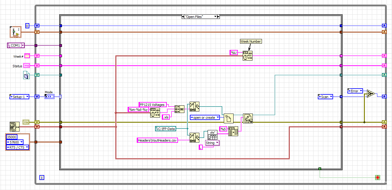

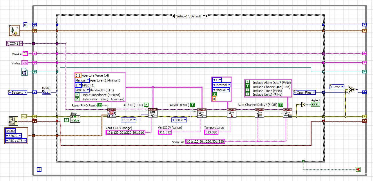

You seem to be having difficulty grasping the state machine concept. I will lead you through one of mine to give you an example to think about. You need to break your program down to descrete tasks, it looks complicated but in the end is is far eaiser to maintain.
First I initilize my instrument, in the case an Agilent 34901 data logger.
Then Open a data file (this program is a modified version of a larger program that used two data logggers and opened multipule data files every week) Notie: The week number is placed in the shift register so I can check it later.

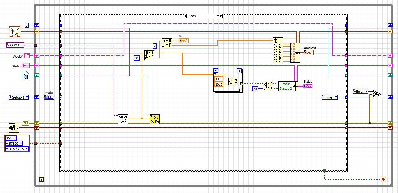

Then I imendendly goto the Scan state and take readings the scan state also displays the data and writes it to the file.

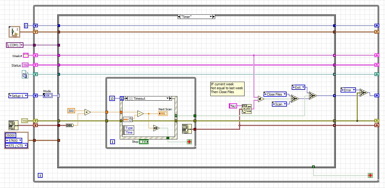

The I wait for the next scan interval in the timer stage, notice here the week number is checked and if it has changed I goto the close file state instead of scan.

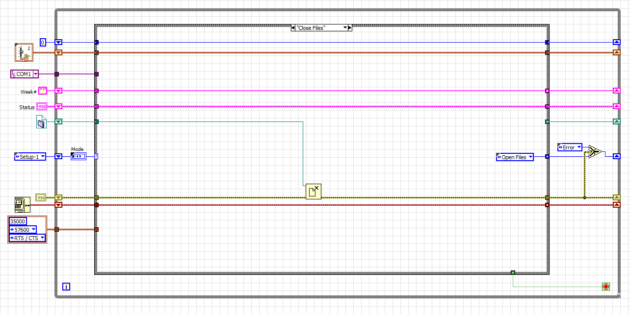

Lets say the week has changed so we will close the data file.
And open a new one by jumping back to the "Open Files" state and the program continues...
=== Engineer Ambiguously ===
