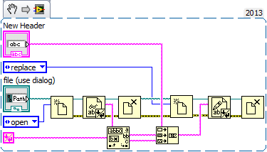

What about doing this after the file with the wrong header is created?
Or using whatever the line termination character happens to be.

You are using Express VIs (which limit what you can do) and have chosen to write a text-base LabVIEW Measurement (.lvm) file that has a specific form/format defined by NI.
If, instead, you do your own file I/O, you can write the file in whatever format you desire.  If you choose wisely, you can come up with something that is (a) easy for a human to read (which means text-based or perhaps an .xlsx file opened in Excel), (b) easy to parse, and (c) easy to maintain and modify.  It will be slightly "non-standard", but it is not hard to develop and will do what you want, not what you have to do.

Thanks a lot minions, I have used a similar programm and it solved my problem!
