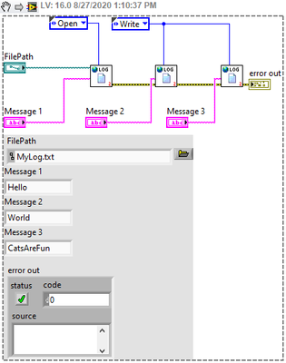

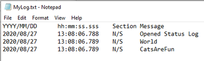

If you run the subVI from within another VI, it works fine. The issue is that LabVIEW will automatically close opened file references when the VI is closed. Your refnum is being stored correctly, but the file is being closed.
There are two ways to fix this. First is to use it as-is; when you call the VI from within another VI, it works just fine:
(I am guessing you're calling it multiple times manually, which doesn't work because the reference is closed automagically)
The second way, and the way I'd recommend, is to not store the refnum but to store the path. Each call would then open/write/close the path. This seems to be a status logger, so it's not going to be called hundreds of times a second, so the overhead with reopening the file is minimal. The reason to do this is so that the file gets reliably closed. Note in my example that I did *not* close the file, but that it was fine; that's because LabVIEW saw that I wasn't using the reference anymore and auto-closed it. In the dev environment this works, but in a normal application what happens if the user force-closes the application? Or what if it crashes? Or what if you have some edge case where the file doesn't quite get closed properly?
