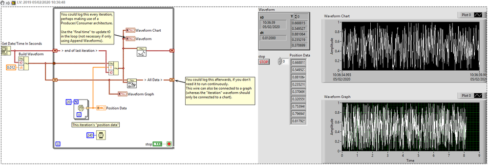

If you share the code you're using, we could give better comments, but if you believe the timing is 12ms always (or at least, you're happy to record that as your time series) then you can go ahead without other acquisition devices.
TDMS will allow you to log a waveform datatype, if you'd like - in this case,
  • set t0 to your start time (you can use the Get Date/Time in Seconds node perhaps)
  • set dt to your period (0.012 seconds)
  • set the Y array to your acquired data (position?)
Update the values and log as required.
