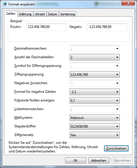

I work on a german system, and the commas are used for decimal separation, the period is used for grouping numbers. And the list separator is a semicolon, so on my system it works perfektly to tell the "Array to Spreadsheet" to use the semicolon as a separator. Doubleclicking on the file opens it correct in Excel.
If your data itself includes semicolons, you have to wrap it in " so excel doesn't separate the data at wrong positions.
I find my settings via system control, region and language, in the first Tab (formats) the "More settings" button and then it looks like this:
Greets, Dave
