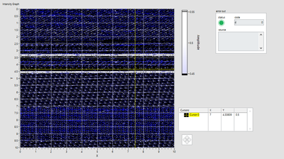

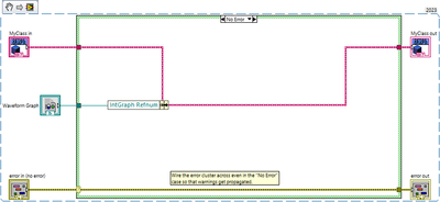

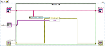

I put a generic IntensityGraph Refnum into class private data. When writing to its value property node the values
are correct, but the rendering is a complete mess. I did reboot but the behaviour is the same.  Is this a bug?

Hi Quiztus2,
Just reset the value to an empty array at initialization.
The graph may have kept values from your previous runs.
EDIT: Intensity graphs have no history, so this is probably not the issue.
