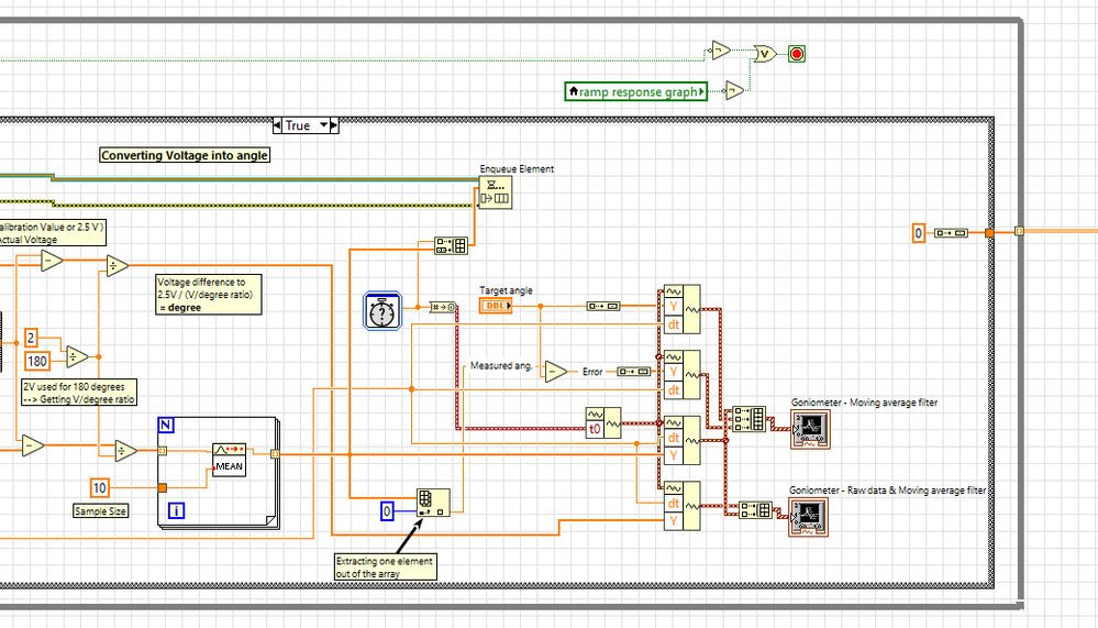

So hello again,
So I guess what I'm trying to suggest is that beyond the "error searching purposes", in general (with new LabVIEW programmers) Local Variables are pretty overused.
There are a few reasons to use one (or else maybe they'd have been removed/never added?) but if you can use a wire instead, that's usually a better choice - even if it makes it a bit messy with wires everywhere.
so I should use wires instead of calling the local variable by its name? Why is that? Shouldn`t it be updated or is it sometimes not possible because of a loop for example?
I tried my best to apply the advice from GerdW but apparently I failed.
I don`t know why the notifier just reads one value and stops afterward.
My DAQx is not running while waiting for the next value too.
Can you please explain the mistakes I have done?
Thank u in advance!
johnson
P.S. The program I attached is just a part of the original program, but this is the part I`m struggling with. Hopefully, I included all the important stuff.

Hi johnson,
apparently your message was trapped by the SPAM filter, but will appear later…
But I already wrote some answers on your VI:
No, you did not follow my suggestions: no error handling, unneeded sequence frames, unused terminals due to heavy overuse of local variables, coercion dots, not used AutoCleanup, …
Locals avoid to THINK DATAFLOW, the very basic principle in LabVIEW. (And they cause race conditions and data copies in memory…)
On the notifier problem:
I don't see the reason, but I see your "unconventional" use of the queue: Why do you enqueue in TRUE case, but dequeue in FALSE case? What's the point here???
Please cleanup your VI before posting again:
  • no locals needed!
  • no sequence frames needed once you use DATAFLOW!
  • duplicated code in case structures belongs outside the case structure (like SendNotification or the check of the loop stop conditions)
  • what's the point of reading BytesAtPort as fast as possible in a loop? You get the very same result without that loop by just reading 1 byte from COM port with sufficient timeout value!
  • what's the point of reading the "miilisecond timer value" from WaitForNextMultiple and comparing it with (a scaled version of) the loop iterator???

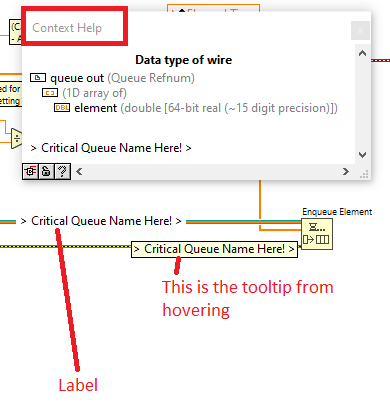

If the desire springs solely from wanting to associate names with wires, you might find Labels useful. Right-clicking on a wire and choosing Visible Items > Label will allow you to specify a label for that wire, and so Context Help (Ctrl+H) will display the name when you hover over it, and the label will be placed over/near the wire (you can drag it around to place it as desired).
Wires can have labelsWires can have labels

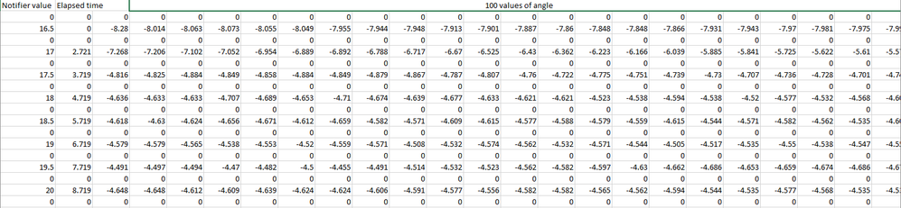

Okay, so until now I can at least save data (angle and the notification value) like this:
First of all, I don`t know, how to get ride-off the zero in between the dequeued data. During the false-case I dequeue the obtained data, but what can/should I connect to the tunnel during the true-case. Maybe a "," as I use it to separate the different variables?
Do you know how to formate this table in a proper way? For example how to write the different dequeued data of the measured angle in one column among each other? And how could it be possible to write the stimulation intensity (100 times bc of 100 measurements regarding this intensity) next to the referring angle?
Once again, I have to thank you guys for helping me!
That exactly is the problem: you are writing a 1D array to that autoindexing tunnel in the FALSE case - and in the TRUE case you are writing a 1D array containing "zero" to the very same tunnel. And now you wonder where those rows containing just "zero" are coming from?
Again: your use of the queue is silly: no need to write to the queue in the TRUE case, just to read it in the FALSE case!
You are still using a lot of locals, including race conditions (like "Save path"). Btw. there are also race conditions possible with global variables…
You are still don't do any error handling.
You are still using the "millisecond timer value", which (mostly) is nonsense…
Still duplicated code in case structures (like writing to global variable "L1 temp"/"L2 temp")…

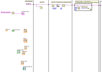

Thank you for attaching your code.  This is the first I'm learning that you are using VISA to collect data, so it isn't strictly timed (as I was assuming).  Sadly, this somewhat complicates the data acquisition ...
I noticed that you are "playing" with concepts that you don't quite understand.  I see what I think is supposed to be a Producer/Consumer design -- there's a Queue that is created and sent into a While Loop with a Dequeue function, clearly meant as a Consumer, but that's the only place the Queue wire is used!  If you are not going to Enqueue anything, you don't need a Queue.   One wonders whether you need a Notifier ...
