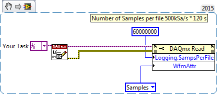

(4,874 Views)
Look at the Modified code I am sending, I haven't had a chance to look at your VIs yet.
There is a property node that will break up the files automatically, I added it to the original example.

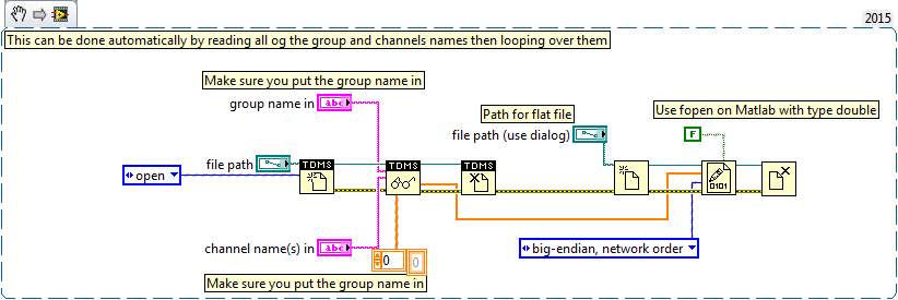

2) How can I load this huge data into Matlab (accurately without any data loss) for further processing. There are many codes (Matlab codes) available on Mathworks and NI forums but every code has some bad reviews. Can you please tell me the latest and most optimized way of loading all my data into Matlab?
Batch convert the TDMS files after the data is saved. You can save each channel in a separate file as a flat double binary and tell Matlab to import that.

Can you please elaborate this:
"Batch convert the TDMS files after the data is saved. You can save each channel in a separate file as a flat double binary and tell Matlab to import that."
I didn't understand this.
Can you give me example or steps to be followed.
Sorry for the inconvenience
Regards
Message 9 of 10
(4,859 Views)
Accepted by topic author Amartansh13
This example here is for one file and one channel, you should be able to loop over this automatically. The bottom comment should be channel name, not group nameby the channel name in control.
