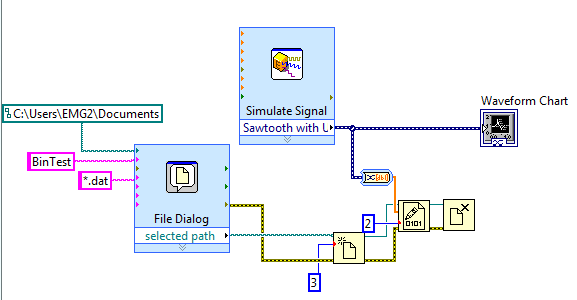

Ok, I see what you're referring to now.  Yeah, I've been using Labview for all of 2 weeks now so I'm not comfortable optimizing the developer's code at this point.
I have 2 goals: Stream data from a single channel and save to a binary file, Then verify that the data has saved by reading it in labview.
From there, I would like to be able to save data from all 16 channels into a single file.
My problem is even without the dynamic data type, I can't save data from one channel as if it were a waveform.
So I'm asking if there is a way to save data that is constantly streaming that is different than saving a pregenerated waveform.
This works:
This doesn't.  And the file path/ref num is generated in the same way.

turtl,
I see that you are saving your data to a spreadsheet.  Is that working to any degree?  Although I'm trying to save to binary, do you think I need to pull the data directly from the EMG and ACC VIs rather than after the channels are indexed?

Turtl,
Is that working for you? can you save the data successfully now?  I've tried writing to binary, .csv, and text from a single channel or from the double array and I'm not getting anything in the files.
