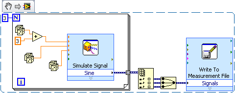

writing signals to LVM file will probably satisfy your needs.
Regards.
