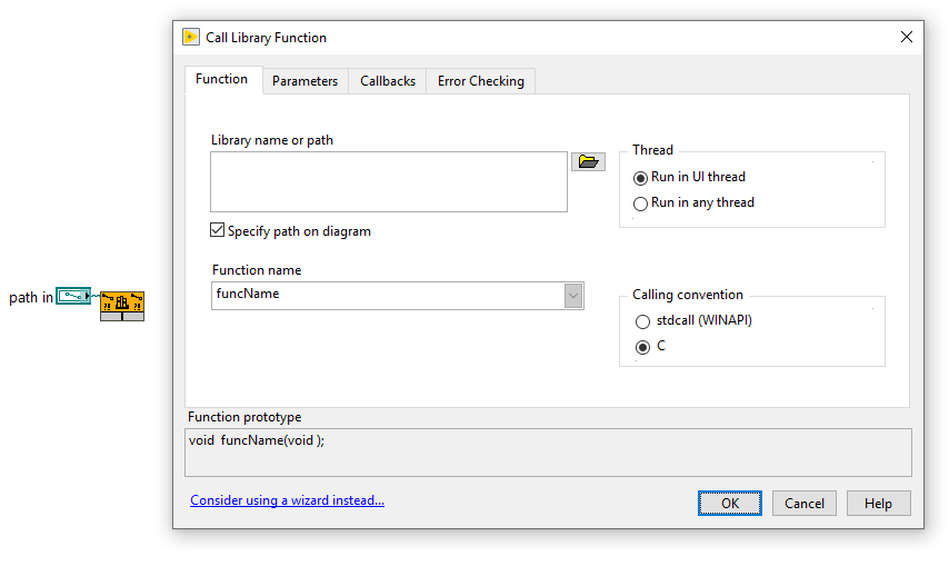

Try to specify a path on block diagram, if you want an absolute path; that may help.  You can make the path dependent on whether you have an exe or the IDE.

If you want to have the DLL installed independent of the LabVIEW VI library you should instead only enter the DLL name without any path or configure the Call Library Node to get the actual DLL path passed from the diagram.
If you configure the Call Library Node to contain the DLL name only, LabVIEW will NOT copy the DLL into a built application but assume that it is provided on the target system as a DLL installed by other means into one of the well known Windows search locations for DLLs.
If you really want to install it into a special path like C:\Autani you only have two options here:
1) Only specify the DLL name and make sure that that folder is added to the PATH environment variable.
2) change the Call Library Node to have the library path passed from the diagram and pass this specific name to it.
