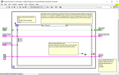

Now that I got that bit solved, I'm working on getting the latching mechanical action correct, and have the control always initialize as false. My solution was to just wire a false constant to the Data out in the Facade VI as shown, but I'm not sure if that's the best way to go about it. But if I just wire it directly, then once the control is for example used to stop a VI, then the next time the VI runs the control reads as true still.
There's an old post about this that I wasn't sure about necroing or not, that you actually commented on Paul. Any advice on the latching behavior in my situation? Like I said this is an introduction to XControls for me, but I do like the idea of a System Boolean with extra customization options that are continually thought of and added.

The only way to do it is to have a background task polling the Xcontrol.
(2,795 Views)
I guess it would be less than ideal to have a background process for each of these buttons in a UI. Cool solution though and thank you for the code!
