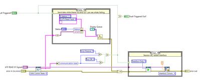

Originally, I thought that my code was going into Bus Off mode (LED 1 green, LED 2 red) so I added some code that stated "if communication state = Bus Off, start interface only" (Page 4-541 in the XNET help) and some code that would display the indicators associated with the XNET Read (State CAN Comm).  After 3 days, I the State CAN Comm finally changed from default values to the fault value.  Ends up, the transmit error counter went to 128, communication state is Error Passive, and last error is Ack (see image attached).  Based on XNET help, it makes sense that the state went from error active to error passive since the counter went above 127.

Below is a snippet from my code that I used as a work around.  I am querying the communication state and if it is in Error Passive or Bus Off, I restart the interface only.  As far as I remember, I haven't had issues with this code being dropped into my XNET read loop.
Also, We were having some connection issues since our connectors were inside a thermochamber and the heat cycling made them a bit brittle.  We replaced the connectors and wiring after adding this code into the main test.  I'm not sure if this code or replacing the connectors fixed my problem, but I wanted to share hardware was also changed when the issue vanished.
