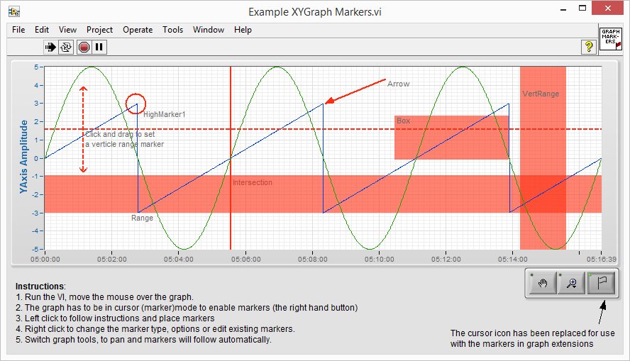

Interesting. But is there any special reason why the time scale increases from right to left?
(5,482 Views)
nope. The timescale is certainly no factor in the graph extensions tools.

Made some more progress to support range markers, you can see an example here and get the source from github link above.
