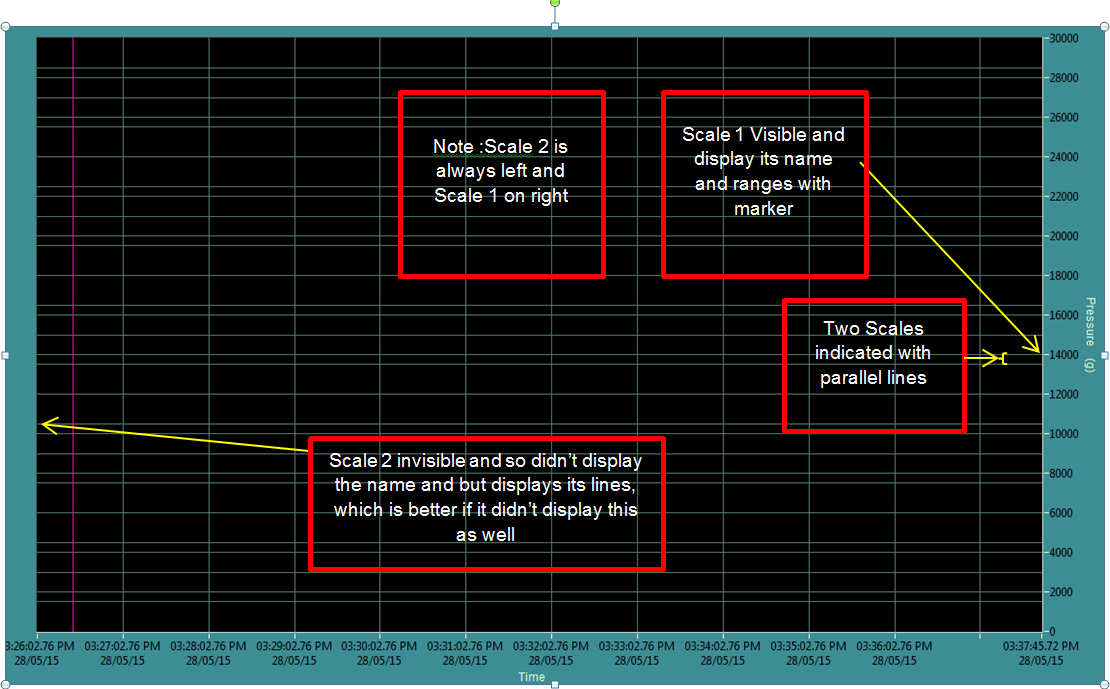

I use XY graph to display the data with 3 Y-scales.
When I set any Y scale Visiblity property to False,its still display the Y scale Max and Min range Lines in plot area of the  Graph and making cross line or extra parralel line with other visible scales.
Attached the screen shot  for ref.
And I know the cross line may be due to different Y scales range setting.But XY graph should not display the invisible Y scales and its property  as well.
please provide your suggestions to avoid that.

The scales and the lines associated with those scales are separate properties. I have never tried it, and right now I am not at a computer, but there should be properties for setting the grid line colors. Set them to transparent.

Mike,
Setting Major grid lines to Transparent looks fine.
