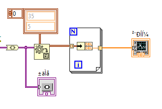

Hi all
    I want use "To More Generic Class"function convert XY Graph data to Waveform chart as attached and snapshot ,please help me check it what is wrong with this code,thanks!!

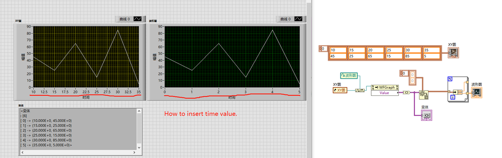

Thanks a lot for your help,it's work ,but how to insert time array to waveform chart as XY graph,thanks!!

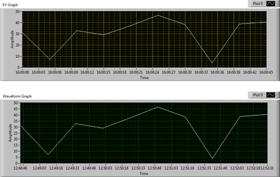

Only XYGraphs have time values.
Other graphs\charts have a regular time interval.

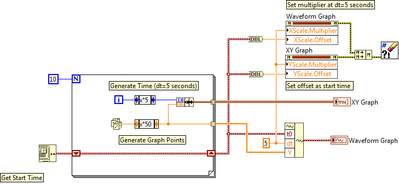

If you know the dT (you can get it from the 1D array data, but it has to be 1 value), you can set it the X Scale with the Offset and Multiplier properties:
(using
Insert Photo.PNGInsert Photo.PNG)
The multiplier would be dT, the offset T0.
Additionally, you can change the formatting of the X Scale, either with a property node or by configuring it. This is particularly useful if you want the X Scale to represent time.

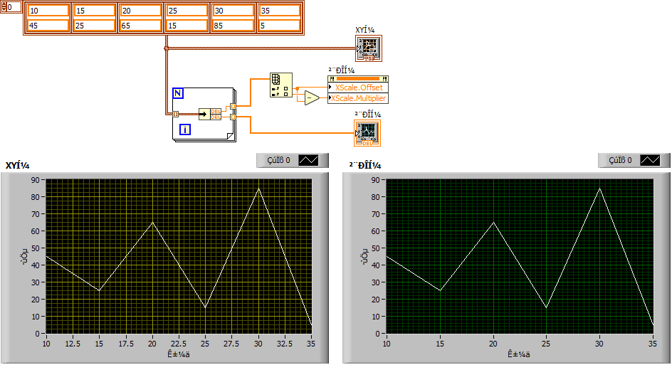

Your code makes no sense, because xy graphs can take a variety of datatypes (cluster of x and y arrays, cluster of xy points, complex arrays, etc.) and doing a class conversion of the reference seems illogical. You need to operate on the data.
If you know the datatype (1D array of xy points in this case), just get it out as follows (we need to assume that the x-values are spaced equally)..

It's appreciated for your help,the purposed for the case is want convert XY graph to waveform graph as dynamic x data and y data,occactional regular or irregular,you method in regular is right and irregular is wrong,which way can cover both issue,thanks!!

Waveform graphs assume equal x spacing. For uneven spacing, you should leave it as an xy graph.
There are ways around, you could resample all data by interpolation of make the dx=1, for example.
