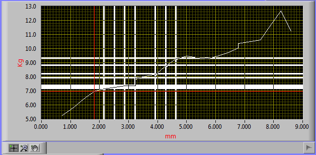

I'm using Coursore for my XY graph.
it works without any problem until i Get XY Graph image after tha when i move cursor i see These white lines !

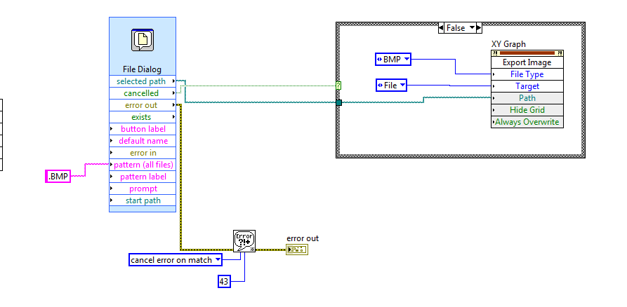

To make the white lines go away do you have to stop and restart the application? Are you using the method to get the image? How is it configured? What happens when you refresh the data in the graph?
We really need to see some code.

Hello
This How I Get The image :
When i refresh white lines disapare.

Well, it seems like you have two options:
1 Refresh the graph after exporting its image
2. Make the graph background white (looks better anyway)

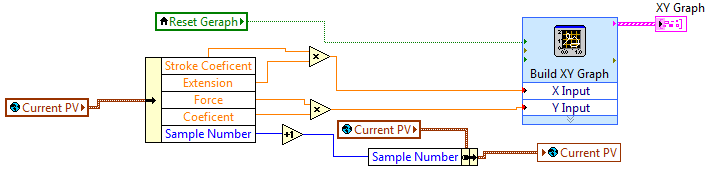

I'm using Build XY graph .How can i refresh graph without excuting this function ?
(3,973 Views)
I would say that yes if verified it is a bug. You don't show where the data is coming from. You shouldn't be using an Express VI do something this simple.

Hello
The data is reading from Servo Drive and Loadcell Transmiter through Serial port.
