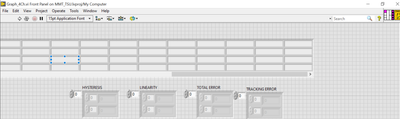

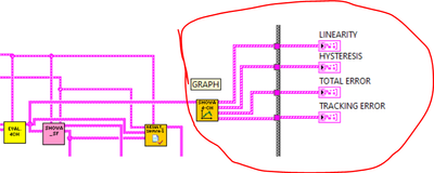

I am plotting an array of data in the XY graph , which works fine in the code , but in the .exe the XY graph is empty .
Pls. suggest how to resolve this issue .
Attached few snapshots , pls. let me know if you need any more info.

From the sub vi I get the XY Array of data ,which I plot the graph .
It works fine in the source code , but when i run in .exe the graphs are blank.
Attached the SUB VI for your reference.

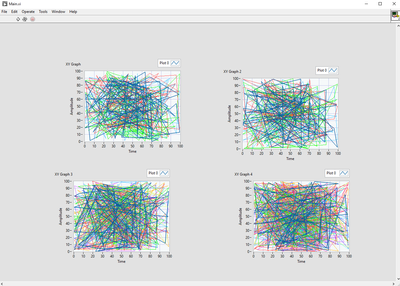

I used your VI as a subVI and generated 100x100 2D array of random data, even scanned to string array to replicate what you describe. Then I built .exe out of that Main VI and the code works just fine:
So the issue will be probably at the input of the VI rather then output.
I'd recommend - start debugging step by step what's happening at your application while running as .exe.
