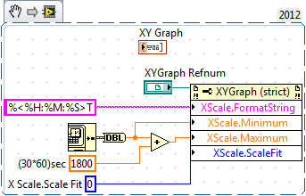

Right click the XY-graph and play with properties and you should be able to achieve what you want.
Below is the programmatical approach to do all that.
XY Graph with properties
Also atatched is the code for the same (saved in version LV 2012).

Thank you! Spot on!
