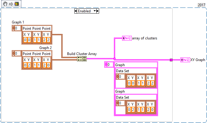

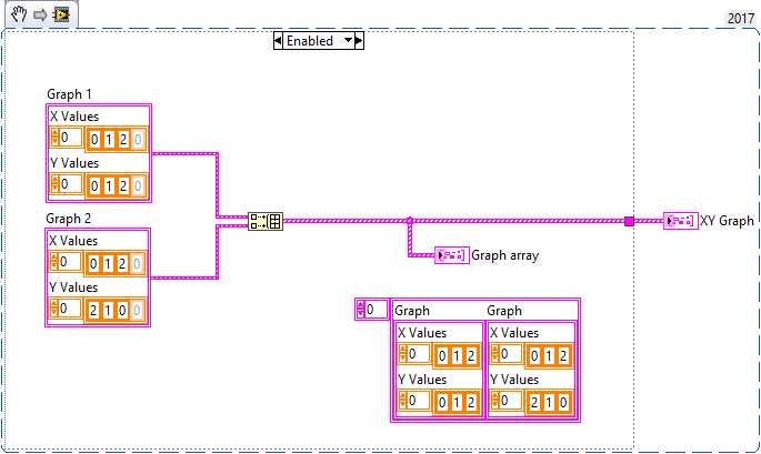

What format is your data in?  If you are using an array of XY pairs, they need to be combined for the graph using Build Cluster Array.

Depending on how your data is stored one of these two methods may be better:

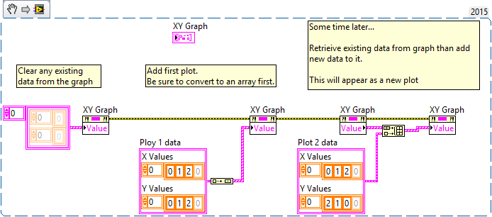

@BENTATA wrote:
But in my states I need to recycle without deleting the previous data and to plot my new data in the same graph.
You can do this using property nodes.  Here's an example.
You can use the reference to the XY graph control to do this in a subVI if it suits your code structure (I couldn't look at your VI as I only have LV2015).
Andy
Message 7 of 13
(5,132 Views)
@PsyenceFact wrote:
Andy
Thanks very much for your help, Could you please tell me how to make my data output as yours  (from a 2D array to a cluster of two elemets). I tried convert array to cluster but it doesnt work.
Message 8 of 13
(5,121 Views)
Array To Cluster only operates on a 1D array.  You need to use Index Array to get the two rows of your 2D array (presumably containing X and Y data) then Bundle to create the cluster.  This can then be turned in to an array.
