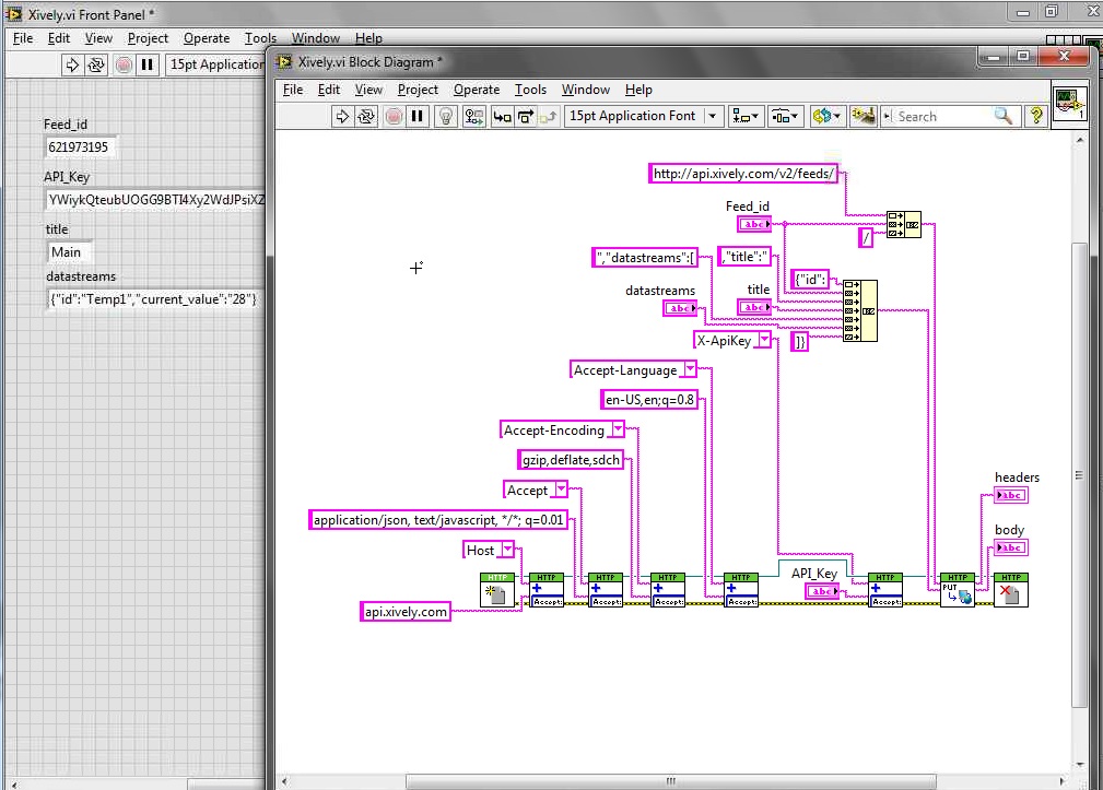

XIVELY1.jpgI was able to do a successful manual put with this setup. now to break it appart and make it to where I can have varibles in the data.

Ok updated again. feed id, api_key, feed title, datastreams data package seperated. I belive this will become a sub.vi to the main that will structure the datastream package of data.

Ok so I have it putting the data from one line onto Xively no prob. going to work out how to format miltiple strings. here is what the Main VI looks like. I turned the vi from above into a subvi that is called every 30sec to PUT data on Xively.

Apologies, I didn't see that you had posted which LV version you were using.
You can use format into string with multiple input parameters - if you use a format string such as "{%s, %.2f, %d}" and expand the input of the format into string function to have multiple inputs you can wire a string, double and integer and they'll be replaced in the format string.
(blog)

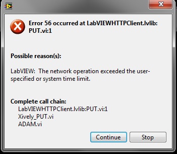

I did start getting a fun error if the internet ichups on the server.
I would like to make something that if it errors like this it will not stop the vi and automaticly continue.

To do that - you need to handle the errors coming out of the PUT VI. LabvIEW has automatic error handling which means that if an error occurs and the error out terminal is not connected it will show the error dialogue that you're seeing.
The simplest solution is just to wire the error out terminals in your VIs to the edge of a structure or use the "Clear Errors" VI to ignore the errors. You can also turn off the automatic error handling in the VI Properties.
Of course...in reality you may want to do something more sophisticated like display the error status (so you can see if the connection is OK) or log the errors.
