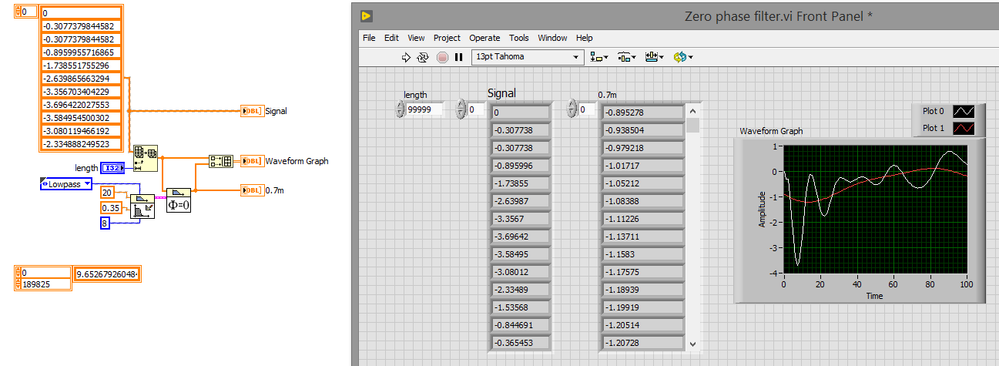

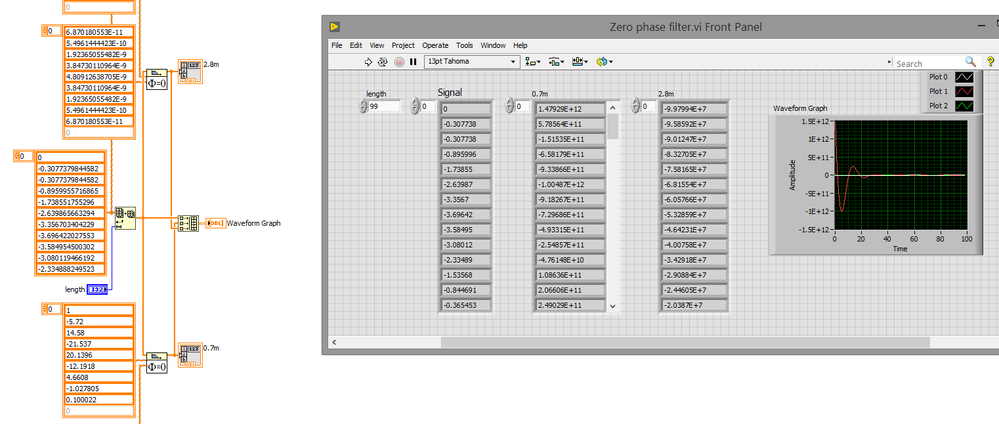

It often helps to plot the data and to limit the amount of data:
The larger you set the "length" of the input data the larger get the resulting values (0.7m and 2.8m). At around length >=2100 the results become so large you only see NaNs… (Because you reach the max value for DBL datatype!)
