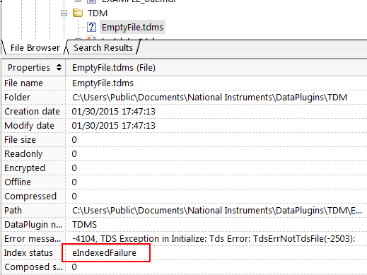

DataFinder does not delete any file at all - only opens files for readig access....
When following the instructions below I cannot reproduce the issue, but receive the expected result: an indexing failure!

Hi Thoult,
This is due to na error with a plugin, a Corrective Action Request has been created: 514529. This is something that is being worked on by the R+D department. On every release of the product, you could see a list of fix issues, you will be able track this issue if you wish by looking number on the release notes.
This shouldn't affect your normal use of DataFinder as any tdms file with metadata or any data won't be deleted.
