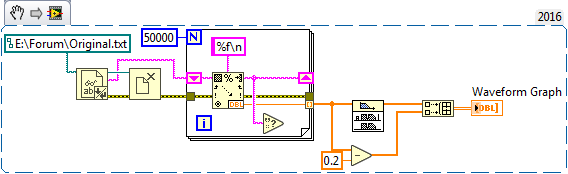

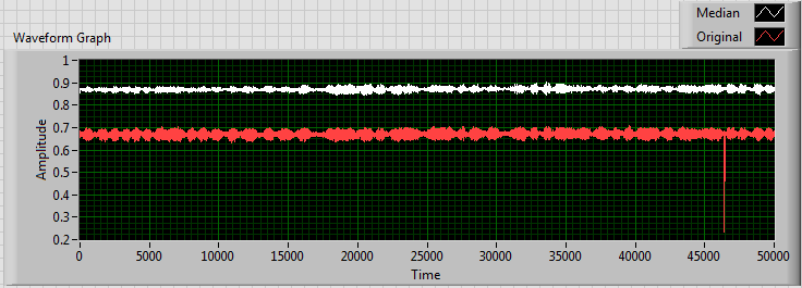

I'm only going to address the Topic, "A median filter that is not working as expected".  I can think of three possibilities:
  • You don't understand Median Filters, and your expectations are wrong.
  • You understand Median Filters, but you programmed it wrong.
  • LabVIEW's Median Filter routine doesn't work correctly.
Here is a demonstration (an example of "Proof by Intimidation") that it is probably Door #2.
You posted a very large text file, Original.txt, with >600,000 points.  I took a subset of these points, namely the first 50000, converted them to Floats, ran them through the Median Filter, and plotted them, along with the original from which I had subtracted 0.2 to "move it down" on the plot.  I'm going to post a picture of the Front Panel, a Snippet of the Block Diagram, and attach the VI.  Note that the Median Filter appears to work, giving what appears to be a Low-Pass-filtered version of the original (certainly the big spike, consisting of a single point, is gone, and the rest of the signal has lower amplitude, less "noise").
Bob Schor
Message 15 of 16
(1,071 Views)
I Concur Bob
I see nothing wrong with the median filter
Digging through the two uses cases in the OP original the ptxpt is going to decimate the data by 50:1 while the median filter is going to glitch once per second.  Nice example
