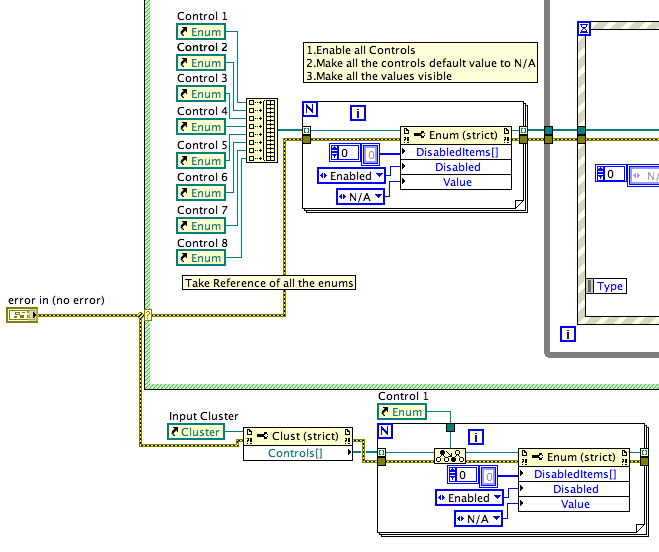

It could be done without making the enum a typedef, but using the typedef is the preferred way.  By using a typedef you are assured that all the controls are identical.  If you need to change or add an item, you only need to change the typedef and all the controls and constants derived from it are automatically changed. For your present application this may not be a big factor, but when an enum is used for the state of a state machine, changes often occur and this becomes very valuable.
ElectroSAM,
Nicely done.  You should wire the error in to the error out in the Error case so that whatever error occurred will be passed to the output.  The Use Default if Unwired option on case structures should be used with great caution.  Many experienced LV programmers prefer to turn that option off.  The only place I routinely use it is (as you did) i the Stop: Value Changed case of an event structure.
Another way to get the enum references is to take a reference to the Input Cluster followed by a property node to obtain the array of references to the controls within the cluster.  You need to a To More Specific Class function to get access to the enum properties.  This is not necessarily better, just another tool.  It can be extended to gain access to any control on the panel.  Search for Ben's Nugget on control references for much more information.
Lynn

@mohansagar wrote:
@electro SAM
what u have posted is working properly,but cant we do it without ' Typedef ' ? and in your vi if "NA" is present at Controller1 and any channel is chosen from controller2 , the chosen channel from controller2 is disabled in controller1, which should not happen. in the corresponding controllers only it should get disabled (i.e from controller 3 to 8).
Hi guys,
I can't get your requirement... According to your quote, I alter the code.
But if you change any of your values in the front panel in decending order, it will work. But if it is in ascending order, your controls won't get disable.
22110iDC65A6BF0BB7EB34
And one more possibility is also there, the user can choose a same option more than one time in ascending order (but not in the decending order).
22108i0E37985E109F31D4
It will lead the program in wrong.
Check it out...
<<May be my code have error, check my code with your requirement>>Smiley Wink
