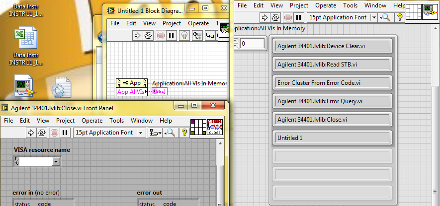

@dacad wrote:
Jeff·Þ·Bohrer wrote:
The Lvlib- Provides a way to group related vis.  Like an Instrument driver or an Error Logger  Its namespacing is "MyLblib:<Name>" on xyz.  so its what functional group in your project.  Of course, the same LvLib can belong to multiple projects they are great for reusable code.  The lvlib knows all its members and where they are just like the lvproj however, the lvlib members ALSO know they are part of the library so we can set some protection on the member access (Private/ public /friendly scope items)  This prevents someone from accidentally reusing code where it shouldn't be used.
The plvlib (Or ppl) is a collection of compiled objects.  its a single file on disk and makes a nice way to distribute packages of functions. BUT is not editable.  The equivallent of a DLL that can only be called from LabVIEW. (That's a gross oversimplification but, you get the point)  Since its a single file, the whole plvlib must load to load any part of the plvlib so try to keep the functionallity closely coupled.
I had previously been told that the Lvlib is also a single file on disk and that it will also be loaded in it's entirety when there is any call to a component located in it.
Is that a true statement ?
in 1000 words- No:
Message 7 of 11
(6,089 Views)
OK,  it's late on a friday afternoon and I am running a bit slow.
So it's not a single file.
And
Only the individual compnents load as called.
Correct ?
Doug
"My only wish is that I am capable of learning each and every day until my last breath."
Message 8 of 11
(6,078 Views)
Silly firewall, I've got a nice capture of "All vis in memory with Close.vi (Agilient 34401A.lvlib:Close.vi)" but I'm not getting it uploaded- I HATE it when some JAVA weenie messes with my LabVIEW mojo
It would show that only "Untitled, Close.vi and Close.vis dependancies are in memory
[Edit: Finally!}
