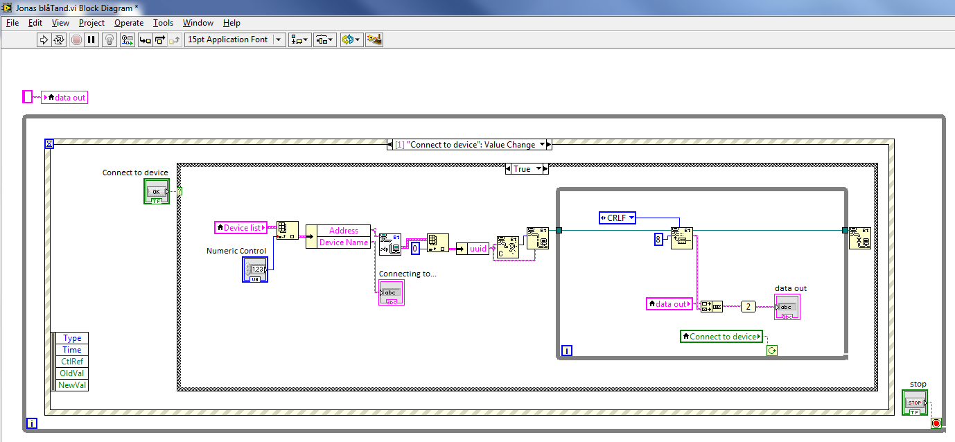

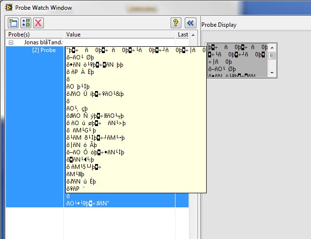

I'm trying to build a VI that recieve the heart rate from the polar wearlink bluetooth device for heart rate acquisition. I have build a vi, but the data from it is just gibberish for me. So I don't know how to transform it to anything useful. I'm using labview 2011. So far this VI looks like:
Data data which comes out from data out looks like:

This is going to be a tough one.
You need to do some detective work.  If the manufacturer does not provide a specification, you can to convert it to all sorts of data formats and plot it out.
Right now, you have the data as a string.  Convert it to an array of bytes and plot it as signed integer, unsigned integer, etc.  Then convert it to Word and try the same.  Then convert it to single and double, etc.
You can tell from the string that there is some sort of pattern in the data.  Hopefully, you will see something in the data that you recognize.

okey, i found out that the messages from the polar should look like this:
fe 0a f5 07 d1 4b 03 3b 03 22
fe 08 f7 08 d1 4b 03 57
fe 0a f5 09 d1 4a 03 5b 03 53
fe 08 f7 0a d1 49 03 66
fe 0a f5 0b d1 49 03 58 03 4f
fe 08 f7 0c d1 49 03 23
fe 0a f5 0d d1 49 03 20 03 1f
fe 0a f5 0e d1 4a 03 2e 03 04
fe 08 f7 0f d1 4a 03 20 fe 0a
f5 00 d1 4a 03 27 03 1d
fe 0c f3 05 d1 5f 02 48 02 4f 02 48
fe 0c f3 00 d1 64 01 02 01 48 06 34
fe 0c f3 0d d1 62 02 12 02 0b 01 3d
and so on. Where the third hex f3, f5 and f7 decides the message size. And the sixth hex is the heart rate.

I have tried several different read options to the bluetooth read function, but still the same problem. Anyone know how what to try? I add an attachment of a picture of the code and the code itself

A wild guess is this has something to do with the message size and the fact that you wire a 12 to the " bytes to read" input:
bytes to read  is the number of bytes to read. Use one of the following techniques to handle messages that might vary in size:
  • Send messages that are preceded by a fixed size header that describes the message. For example, it might contain a command integer that identifies what kind of message follows and a length integer that identifies how much more data is in the message. Both the server and client receive messages by issuing a read function of eight bytes (assuming each is a four byte integer), converting them into the two integers, and using the length integer to determine the number of bytes to pass to a second read function for the remainder of the message. Once this second read is complete, each side loops back to the read function of the eight byte header. This technique is the most flexible, but it requires two reads to receive each message. In practice, the second read usually completes immediately if the message is written with a single write function.
  • Make each message a fixed size. When the content of a message is smaller than the fixed size you specify, pad the message to the fixed size. This technique is marginally more efficient because only a single read is required to receive a message at the expense of sending unnecessary data sometimes.
  • Send messages that are strictly ASCII in content, where each message is terminated by a carriage return and linefeed pair of characters. The read function has a mode input that, when passed CRLF, causes it to read until seeing a carriage return and linefeed sequence. This technique becomes more complicated when message data can possibly contain CRLF sequences, but it is quite common among many internet protocols, including POP3, FTP, and HTTP.

ah okay, now it is working. Added another bluetooth read, and the message size to bytes to read to that one. Thanks! Smiley Happy
