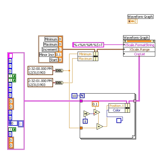

I'm not certain that I know what you're looking for, but this might contain something useful to you.  The first property sets the format of the X axis as you described and the second sets the one-second range you mentioned.  Perhaps you could post a picture of what you're trying to do?
Jim
