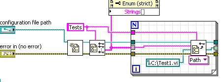

I did whip up a no-frills example of my approach at your request.
Test1.vi is a simple pop-up that is called to demonstrate any test.  Its just a timer and a stop button no frills
Tests.ini is the configuration file that maintains a history of all tests available and the vi to launch (in this example I only launch Test1.vi)
Prompt.vi is a modified version of the prompt user express vi.  I had to add a file path type that is not on the standard pop-up.
Main.vi
 This section reads the ini and sets the Enums string property as mell as read the test file paths
I think the rest of the code is pretty obvious but--- ask if you have any questions

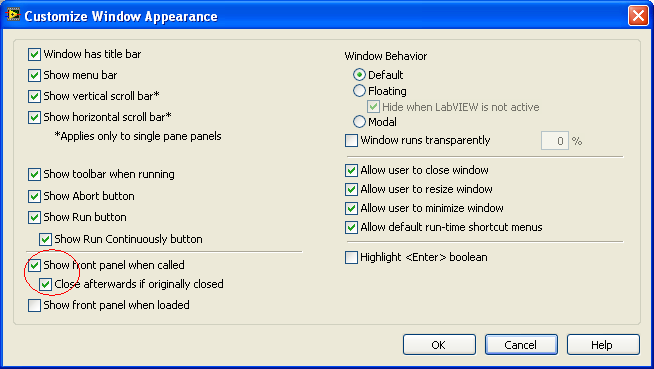

CAUTION:
I rushed a bit so I forgot
To set the VI properties on Test1.vi
Here it is corrected so your LabVIEW does not hang
