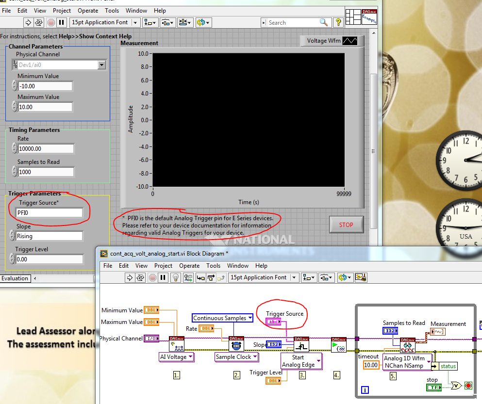

I guess it is due to trigger source that you are using as an analog trigger.Trigger.PNG

Thank you for your answer
Yes, I'm using an analog trigger but Manual NI 9502. I don't have a lot of information about analog trigger.
If I want to have analog trigger with NI9502 I'm don't know what is the source in NI 9502

I guess you are talking about NI 9205??
Here is the complete details on triggering of NI 9205:
http://digital.ni.com/public.nsf/allkb/851828B06A20E01B862571DA0005591A
Short:
Step 1 - Connecting and configuring the hardware
  1. Slot the NI 9205 module and an output module into the cDAQ chassis and connect it to your computer. Find the hardware in MAX and take note of the module names given.
  2. Wire the triggering analog signal into the NI 9205 module. (it can go into any of the analog input channels).
