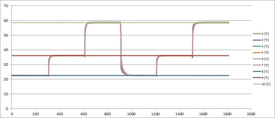

I have this graph
this data is graphed by excel from an output file of a data recorder.
i am looking at 4 main channels.
channel 2 or 7 (they are pretty much the same..purple is behind pink)
channel 8 (dark blue line) 22C room temp
channel 9 (read line) 37C body temp
channel 10 (green line) 60 C extreme temp
from my recorder, i will be doing this test through out, i am not sure how often but i know for sure that these 3 temps are the only values i am looking for.
22, 37, and 60.
is anyway to calculate the time it takes from 22C to  90% of 37C.
how would i put this logic? i want to do it for every jump in the graph.
from 22-37, 37-60, 22-37, 37-60
i dont need to calculate the time it takes from 60-22
can someone guy me in the right directly.
thank you

Look in the Signal Processing->Waveform Measure palette.  The Transition Measurement should do what you want.
