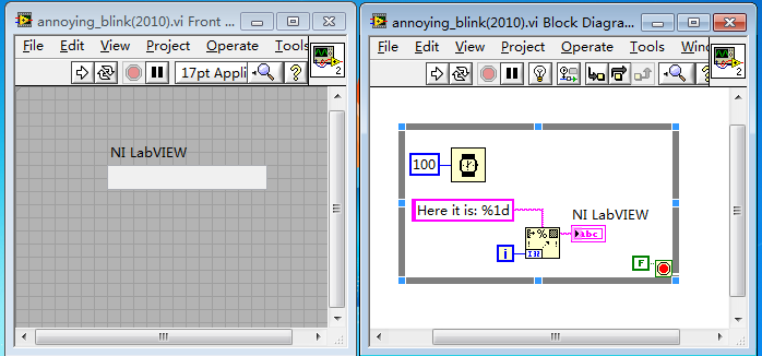

The code is simple as shown below. The string indicator update it value every 100ms in the while loop.
The proble is that the indicator on the front panel will blink (or in other words, flash). This is very annoying.
1. Both LabVIEW 2010 and 2013  have the same behavior.
2. It occurs no matter it is modern, classic or system control.
3. If add more control to the same string source, only one will blink.
4. The numeric indicator has the same problem.

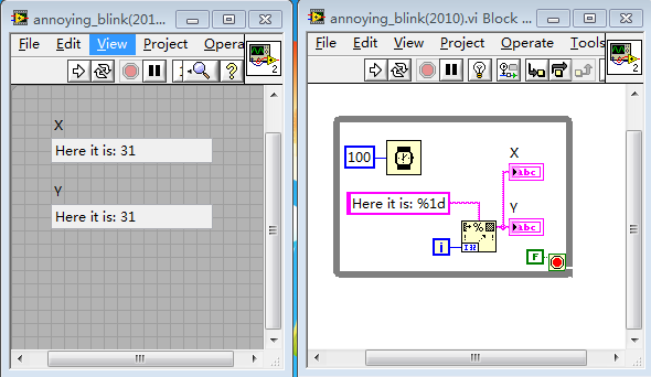

Here, one more indicator is added.
Run the code, and you'll find the two indicator behavior differently.
One blinks, the other works corrently.
