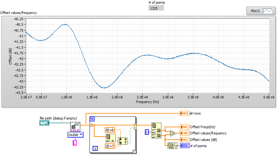

Here's what I had in mind earlier (note that the header drops out anyway because it defaults to zero, i.e. out of range)
As others have already said, a graph is an indicator, not a data source. You need to operate on the data going to the graph.

You have an overloaded goal here. You can either have 1000 value starting with x=2e7, or you can have all values in the range 2e7 to 5e8 (1325 point in your case), but not both conditions unless you remap the data by interpolation. Do you want to do that instead?
If you want exactly 1000 equally spaced interpolated points in your range (assuming the original x values are nondescending!), here's all you need to do:
And since the x-values are now guaranteed to be equally spaced, a plain waveform graph is all you need, to graph dB. Just set x0 and dx of the x axis according to the ramp.
