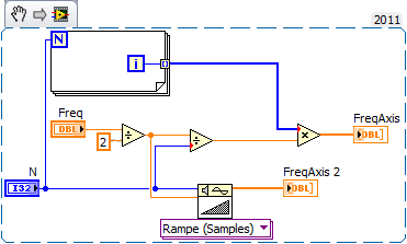

Hi Axel,
why do you need a formula node?
Two possible solutions in one snippet:
You might adapt your settings a little bit, I'm not that familiar with MATLAB expressions…
(4,000 Views)

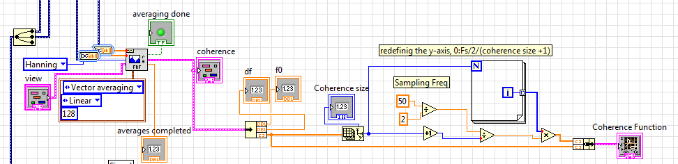

Thanks very much GerdW. it worked well Smiley Happy . However, the coherence function was not as good as I expected.The value of the correlation is 1 at all the frequency. Can someone recommend me a better vi? Perhaps there is something I can do to correct my result...cohere.PNG
(3,975 Views)
Hi Axel,
- we don't know your DAQ data.
- There are coercion dots at the Coherence function, they surely have their meaning.
- You can wire f0 instead of your "Sampling Freq" constant…
- When you want to redefine the X axis of your second plot you only need to change the f0 and df values in that cluster, no need to calculate a new array of values…
Attach the real VI with real data embedded! (LV2011 preferred)
