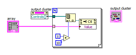

Heres a FOR loop solution.... but why????? 😄 (I would not recommend this)
Message Edited by altenbach on 05-13-2008 12:23 PM
