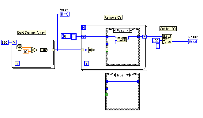

Please see the example below for one way to accomplish this.  I assumed that you wanted to chop the array down after removing zeros.  Please feel free to ask questions if you have any.

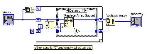

zhao.lin wrote: First, I have a 1 D array coming in. In the coming 1 D array, it contains some  zeros and I do not when it will occur( I dont know which index number it is). I am wandering is there a way to delete those zeros from the incoming array.
You definitely don't want to use "delete from array" inside a loop as others have suggested.
The only efficient way to do this is to operate on the array in-place and trimming it at the end.
Here's a quick code picture:
(for a benchmark comparison of a similar problem, see: this old post. "Delete from aray" inside a loop can be several orders of magnitude slower.)
