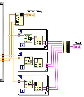

I would allocate a string array at the final size, then replace data as you go. Here's  quick rewrite (LabVIEW 8.5).
(I don't understand your use of the local variable, sequence structure, and while loops. The first two are not needed and the loops should be FOR loops because you know the number of iterations beforehand.
(Also note that you should work with strings for the final table. A numeric array will be padded with zeros for undersized rows or columns. An empty string for missing elements seems more appropriate.)

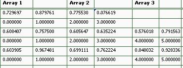

It sounds to me like you want something like the table shown below. The code to do it is also shown below, and the modified version of your VI is attached. The trick was to detangle the arrays you initially made; I would bet your code is not creating the arrays the way you intended-- if you want clarification on that, I'd be happy to elaborate.
In any case, it works fine the way it is!
