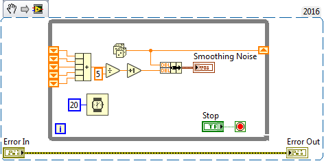

It doesn't really matter what the sub-VI does.  I made a simple Uniform Random Number generator running at 50 Hz, with a running average of the last 5 numbers showing a "low-pass filter" effect, and a Stop Button to demonstrate User Interaction with this VI running in the sub-Panel.  Note that this sub-VI must be closed in order to be called to run in a sub-Panel (otherwise you get Error 1144).
If you have LabVIEW 2016, these are both LabVIEW Snippets that you can drag to a blank LabVIEW Block Diagram and save.  This second VI I had saved as the sub-VI "Do Some Work", and is the VI whose static VI Reference is used in the main Sub-Panel demo shown first.  If you are creating them "from scratch", you should be able to simply lay down the Structures and Functions as I have done.

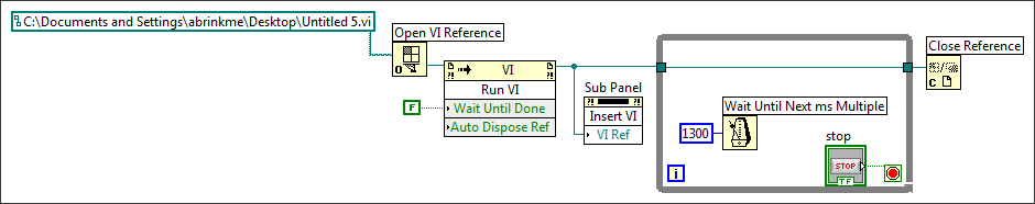

Sorry for the confusion if i had made. Let's get things clear.
-Start new VI and Complete the following steps to load a front panel in a subpanel control.
  1. Add a subpanel control to the front panel. LabVIEW creates an Invoke Node on the block diagram with the Insert VI method selected.
  2. Add the Open VI Reference function to the left of the Invoke Node on the block diagram.
  3. Wire the path of the VI whose front panel you want to load to the vi path input of the Open VI Reference function.
  4. Right-click the vi reference output of the Open VI Reference function and select Create»Method for VI Class»Run VI from the shortcut menu and add the Invoke Node that appears on the cursor to the right of the Open VI Reference function.
  5. Wire the vi reference output of the Open VI Reference function to the vi reference input of the Run VI method.
  6. Right-click the Wait Until Done input of the Run VI method and select Create»Constant from the shortcut menu to create a Boolean constant with a value of FALSE.
  7. Wire the vi reference output of the Run VI method to the VI Ref input of the Insert VI method.
  8. Add a While Loop to the right of the Insert VI method.
  9. In the While Loop, right-click the conditional terminal and select Create Control from the shortcut menu to create a stop button.
  10. Add the Wait Until Next ms Multiple function inside the While Loop and wire a numeric constant to the millisecond multiple input. Specify the number of milliseconds you want to lapse when the VI runs.
  11. Add the Close Reference function to the right of the While Loop.
  12. Wire the vi reference output of the Run VI method through the While Loop and to the reference input of the Close Reference function.
    Refer to the following block diagram for an example of loading a front panel in a subpanel control.
  13. Wire all error in and error out terminals on the block diagram.
-Now notice that you can load a subvi named Untitled5.vi opens in subpanel and waits until you press stop button.
-Now Open VI reference creates the reference to the vi which you want to run.
-VI run Invoke method will make the VI to start executing.
-Subpanel Insert method will insert the subvi front panel into Subpanel.
-The while loop is to ensure the vi is escuting and keep the refernce alive.
-When you press stop the reference is closed and the vi will be remove from the memory.
-You can check if a vi is running or not by creating property node and selecting the execution state
P.S. whenever In confusion start with fresh VI rather than mixing up with already existing VI and complicating it. I hope above post helps if not completely ignore and proceed as suggested by others.
