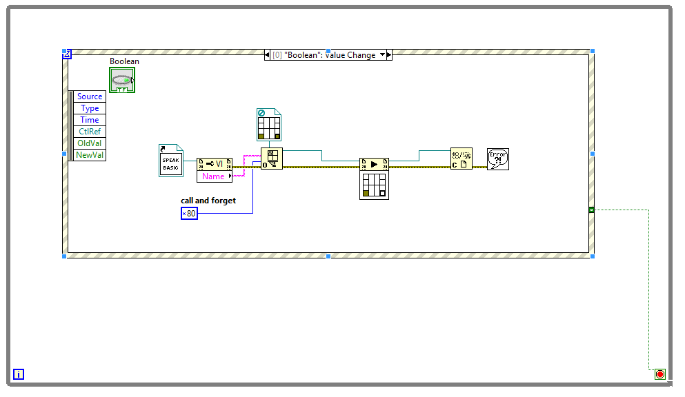

Capture.PNGIt's working just fine, but when the boolean is true you are calling the Speak Text777.vi as many times as fast as you can. Try an event structure instead of a case structure.

OK lets analize that code and explain what you did wrong.
In the caller Boolean is not latched and the loop is greedy So you queue up about a bajillion calls to the non reenterant vi.  they each must wait for the previous call to finish before they can run.
Don't do that! just latch the boolean.
