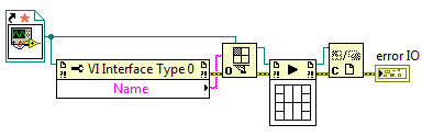

Attached is a code snippet of how i am currently stating an asynchronous call

This is how I always call a VI by reference.  Having the static VI ref causes LabVIEW to load that VI in to memory and be able to find it by name when opened.

The VI Ref with the star is just a Strict reference. You need to input a strict reference in to the Open node because it requires that in order to load the connector pane. The input even says "(for type only)" on that input to clarify. It's kinda weird looking because you have the same VI reference loaded twice, so you can also just make the first VI ref strict and wire it in to both.
I wish I could mark that post solved twice!  Thanks James!

@JÞB wrote:
Thanks James!
Digging up old posts for the fun of it?
I actually consolidated a little bit because I realized I didn't need two static VI refs when the strict one can do all the work.
Cheers
