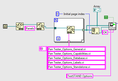

I would still like to know how to include them in the EXE.  I am 90% certain that they are there but for some reason, the Options Dialog Framework doesn't see them.  I use the following code to call the ODF and pass the paths of the VIs.  When built as an EXE, this should be the path to one of them inside the EXE:
C:\Program Files (x86)\TestSTAND\TestSTAND.exe\Panels\Fan Tester_Options_Capabilities.vi
Can a VI be called that way within an EXE?
Could it have something to do with the dependencies of the VI being called?

If the calling VI in your image isn't at the top level of the EXE, you won't get the right path.
What error do you get when you try to load the VIs this way?
When you run the executable, with the dynamically-loaded VIs outside the EXE, are you running on your development machine? Does it still work if you move it to a machine that does not have the development environment installed? That would indicate a dependency issue. It's certainly possible that you're not including all the needed dependencies for those dynamically-loaded VIs, and that when they're outside the EXE those dependencies can still be found elsewhere because the relative path hasn't changed, but that when you put them in the EXE they're looking for those VIs inside the EXE and not finding them.

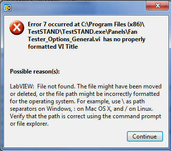

I have not tried running it on another system as you mentioned.  The VI in the previous picture is my main vi which is called dynamically from a splash screen.  The error I get is below. I have tried including the ODF.lvlib into my project so that my project has the dependencies available.  I dropped in a static reference to one of the options pages in the main vi and requested the path to it.  I get the exact path listed in the error screen below but for some reason, the file can't be found.

I just realized that you may be referring to the VI that says "Custom" on the icon.  That VI is part of the ODF framework and is located in user.lib.

I guess that what i am trying to do is not possible.  I found this post where someone is using the same toolkit and received the same error.
http://forums.ni.com/t5/LabVIEW/No-properly-formatted-VI-title/td-p/2137768
