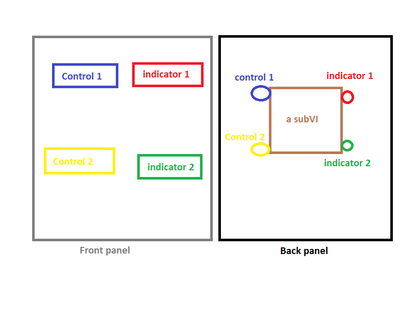

I'd like to know if it's possible to automatically create the indicator and control on the front panel when you put a subVI on the back panel.
For example i just want to drag my subVI on the back panel and the diferent control and indicator is automatically created without go in the back panel and create it 1 per 1

Everytime an user insert a subVI I'd to generate the Input and output of the subVI .
I've got a library of subVI test, the users choose their tests and insert it for create a test sequence.
For specify the different parameter of a test (a subVI) the user have to see the control and indicator of the subVI on the main VI front panel without create them 1 per 1
