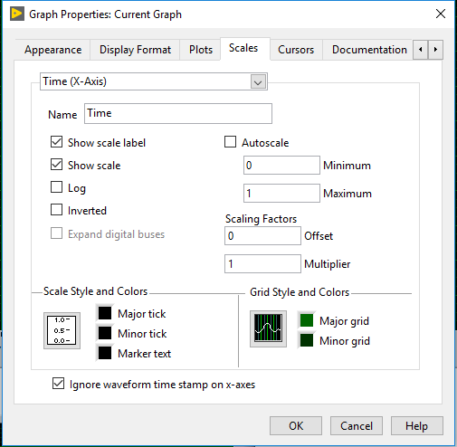

axis X time in the Waveform
Hi ,
I want to know what is the unit of the axis X in the waveform graph (Second , minute ..) ?
Thank you ,

Hi Emna,
the axis has no unit: it's your decision what is displayed on the X axis!
Notes:
  • LabVIEW counts seconds in timestamps: when you format the X axis to show timestamps it helps to present data values, calculated as "seconds".
  • I recommend not to use those "units" for float values, as (partly) supported by LabVIEW classic. That unit support is buggy and will be discontinued with LabVIEW-NXG.
