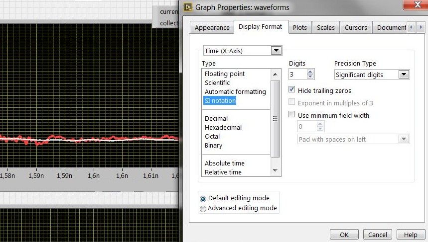

I could not find any answer searching the forum. How can I get rid of the duplicate values on my axis, please? Below is a screenshot of the axis with the settings for the display format. I do not need higher precision - three significant digits are OK. But I want the values displayed at the correct positions avoiding duplicates.
Thank you for listening! Any suggestion is welcome!

Hi ghighuphu,
change the x axis formatting! "Duplicate" entries are due to rounding according to your settings…

Dear GerdW,
thank you for your observation, no need for the exclamation mark. Could you point me to the right direction please? Which settings did you mean specifically?
I really tried hard to change the setting available with no positive outcome. The values are rounded due to the "Precision Type: 3 Significant digits" or "Precision Type: 2 Digits or precision". But I do not want values such as 1.615n or 1.595n -- appearing for settings "Precision Type: 4 Significant digits" or "Precision Type: 3 Digits or precision". I just want to see the most relevant ones 1.6n or 1.61n (or 1.60n and 1.61n) on their correct positions and without duplicates. Compared to the current picture, I want an axis, for which every other (duplicate) value is missing.

Hi ghighuphu,
don't hide trailing zeros when you want number like "1.60n" been shown…
One more note: when the x axis range is too small (like 1.59n to 1.61n) the graph tries to display a certain number of ticks between min and max. Those ticks will get displayed according to your formatting settings and so lead to "duplicate" axis values. You need to set the tick steps to atleast 0.1n in this case - there's a property node to do so!

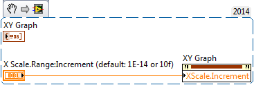

I was able to set the tick distance using the XScale.Increment property value. Thank you for your kind help!
For completeness, here is the value I had to set to remove the duplicates for the example above.
Message 7 of 10
(6,621 Views)
