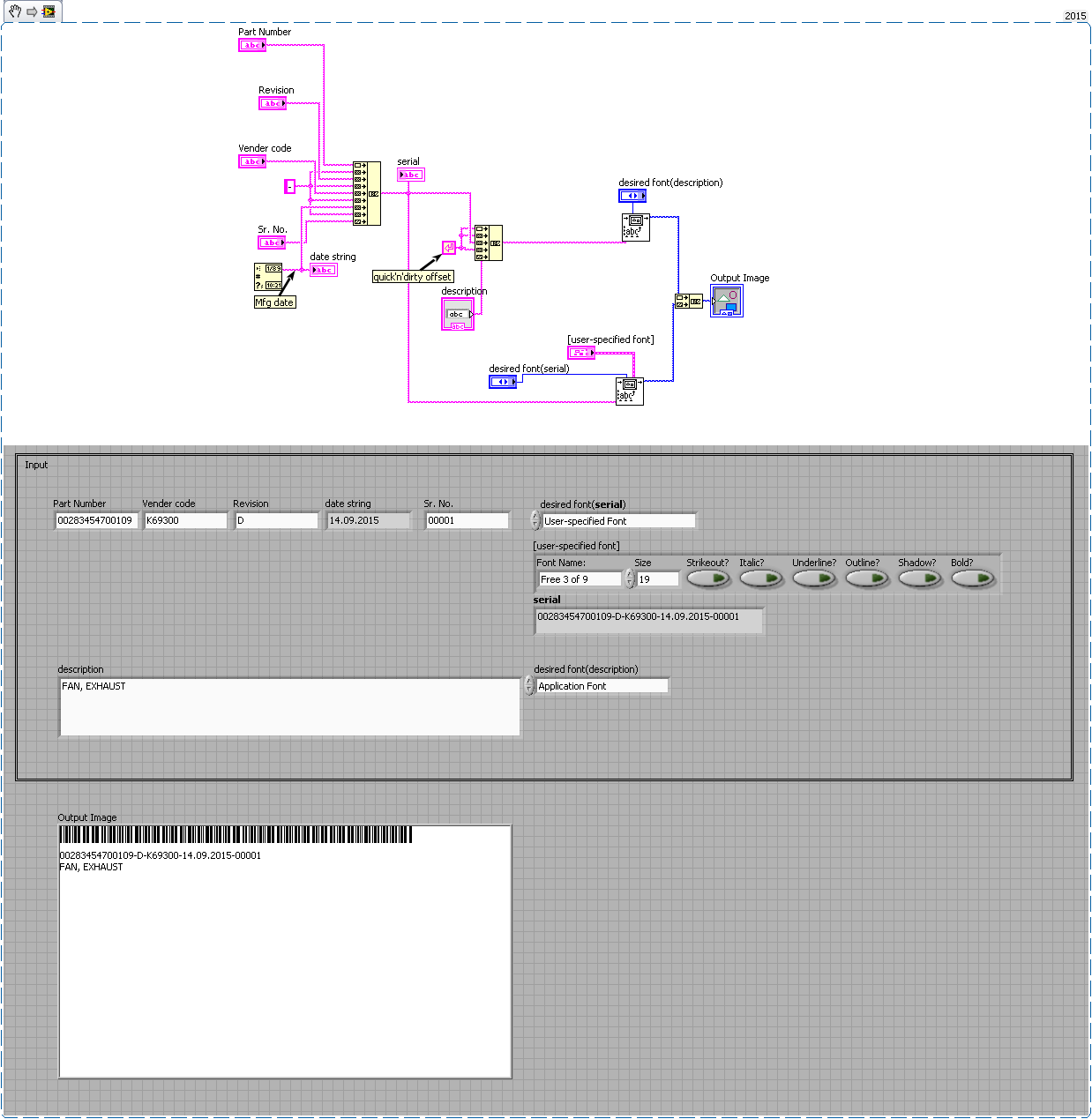

hi rk_t,
The "3 of 9" font does encode numbers and capital LETTERS but does not encode  small letters:
Nevertheless, I rather use various fonts to creat an image before printing:
You might also be interested in this libraray which is written in plain LabView: https://decibel.ni.com/content/docs/DOC-14718

Hi Alex,
Thank you for your response.
I have implemented your VI. But it does not show me the barcode. Rest everything is working fine.
I also tried installing the font again.
Message 3 of 9
(9,368 Views)
Alex,
Got it, I changed a few settings.
The image is a bit blur.. Is there any way to improve it?
Message 4 of 9
(9,365 Views)

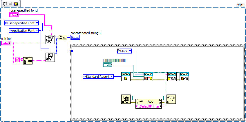

Ok.  I took the solution provided and modified slightly for my own application, but it will not print the concatenated string.  I tried changing the report type (when html is selected, the headers and footers do print, but concatenated string still does not).  any thoughts?  I have tried Free 3 of 9 and Code 128, both of which are supported on my printer and listed in the barcode fonts section of the printer properties.  the concatenated string always displays correctly... it just will not print
Message 8 of 9
(8,971 Views)
figured it out.  I guess the default margin size is set to 1" - despite the settings on the printer.  I had to drop in Set Report Margins.vi to get it to print correctly... however, it is printing a box around the barcode image... anyone know how to make that go away?
