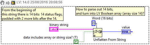

The Siemens PLC sends a specially structured binary string. We use a single TCP Read function to read out 32 bytes in form of binary string. The first part of the 32 byte structure is a Word (16 bits). This part stores the size of the rest: value 30 (bytes). We use the Unflatten From String function, since when we unflatten first the first 2 bytes, it outputs the rest: 30 bytes. This 30 bytes contains some more data, including 14 bit flags (size is 14 bits). Since the PLC can only put "together" Words (16 bits) at its side before sending the TCP data, the 14 bits is padded with 2 bits not holding any valueable info.
The question is that, how should we use the "Unflatten from string" function in this case? So the PLC send 16 bits, we need to get the values of the first 14 bits: and convert them into a LV Bool array containing 14 Boolean values.

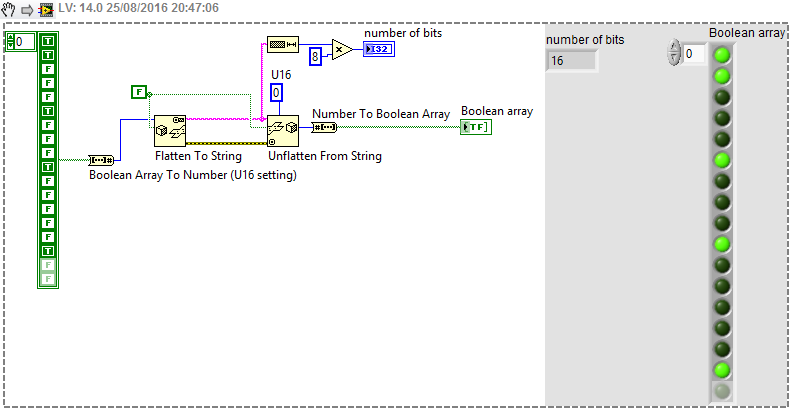

Haha, it is indeed simple solution! Thanks! 🙂
This is what is in my mind based on your info, this should work in both direction, yes?

That is mostly what I was thinking.  Some quick notes:
1. No need for the FALSE constants with the Flatten/Unflatten To/From String since you are not using arrays at that point.
2. The PLCs I have had to talk to like this used Little Endian data.  So just be aware of that.

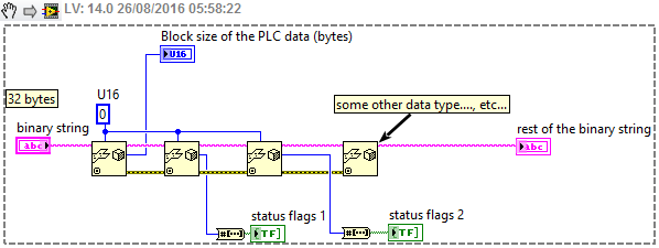

Thanks altenbach! The only difference here is that, if the binary string has more data after the starting 16 bits. In this case I imagine the typecast will try to convert ALL the string into Boolean array, yes? The "Unflatten from String" has the benefit that it gives me the rest ("rest of the binary string") so I can make a conversion "chain" through the special PLC data structure:
