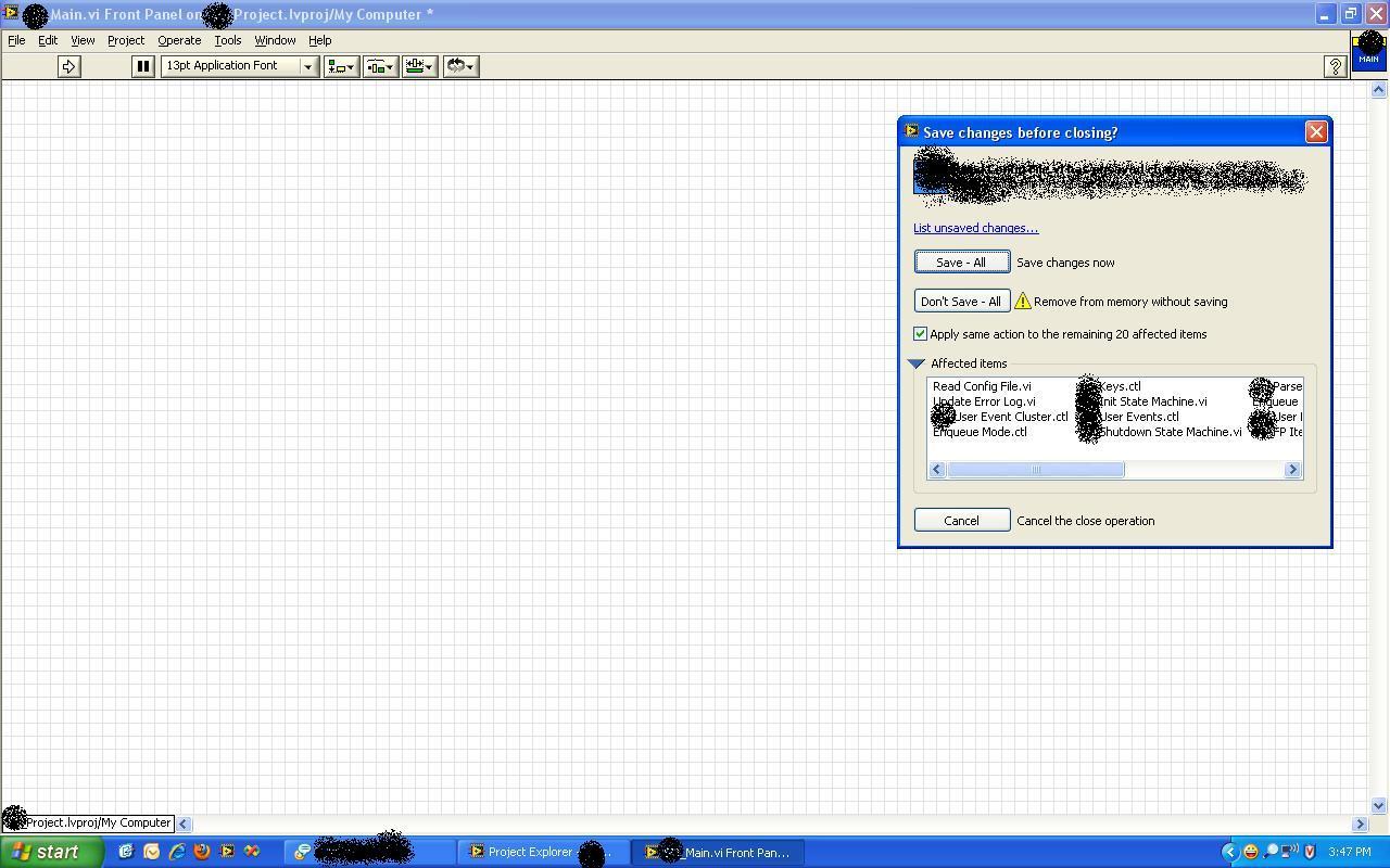

Repairing LabVIEW did not solve the problem. Here is a screenshot, not the scroll bars and that I've turned on the grid to look for any decorations. I've blotted out all project identifying information.

That's the wrong screenshot, but I was able to get it working either way. Video driver, fresh copy of the file and a reboot. May have been the file, may have been the driver.
